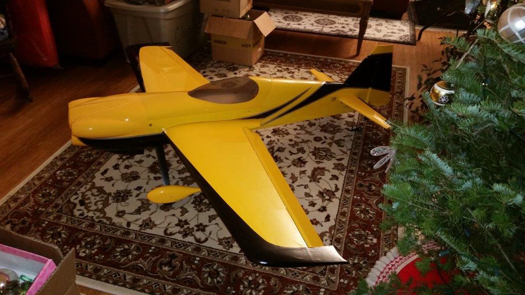

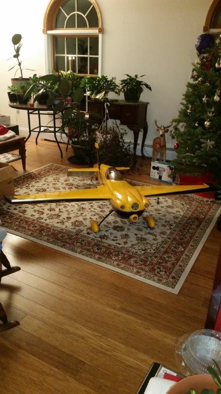

Here are the original pix the day I brought it home:

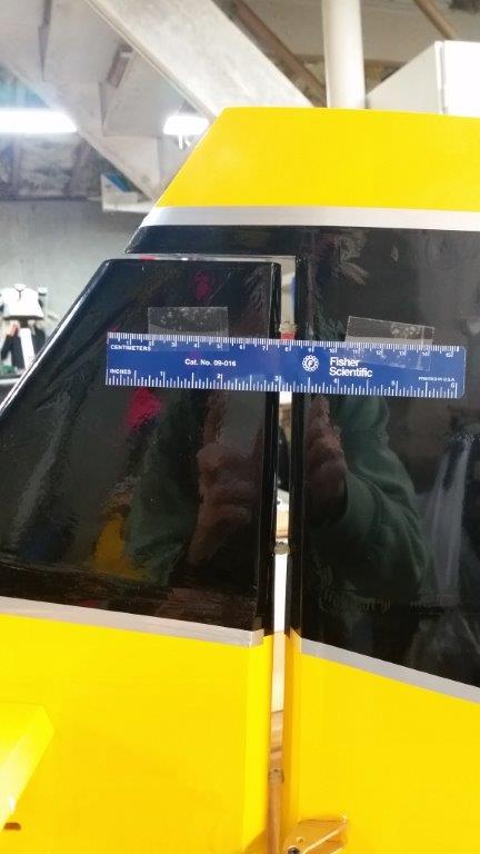

As I stated in my original post, the original owner glued the control surfaces with HUGE GAPS!!
That is the first issue I am addressing.

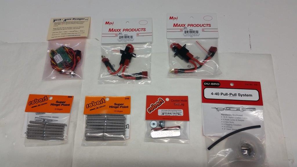

Hopefully I can drill out the old hinges & replace them.
The hardwood blocks inside the structures are too small to relocate the hinges, Sooo... I'm gonna have to drill out the originals.
Also have servos, pull-pull cables, & other bits & pieces ordered.

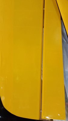

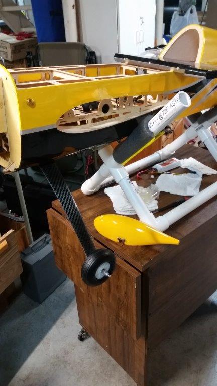

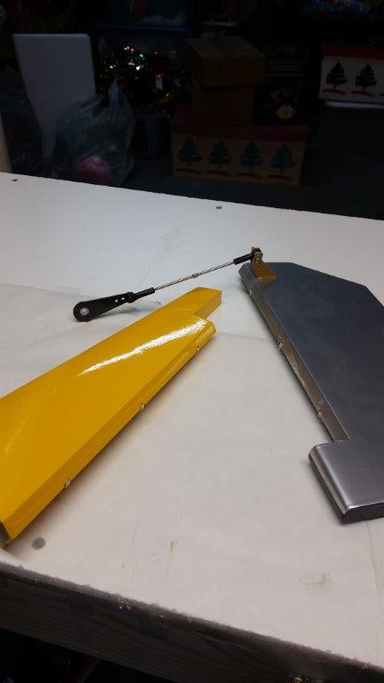

Horizontal Stab & Elevator separated.
Now That's a Hinge Gap!!

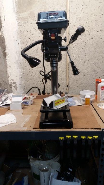

Harbor Freight drill press. (Will drill straighter holes than I could by hand)
Also got a V-Block for it to hold rounded pieces.
And the hinges & other stuff showed up, so tomorrow i can start trying out the drill press. :o
Needed this to drill the old hinges
The assembled Drill Press

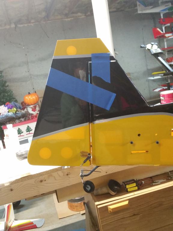

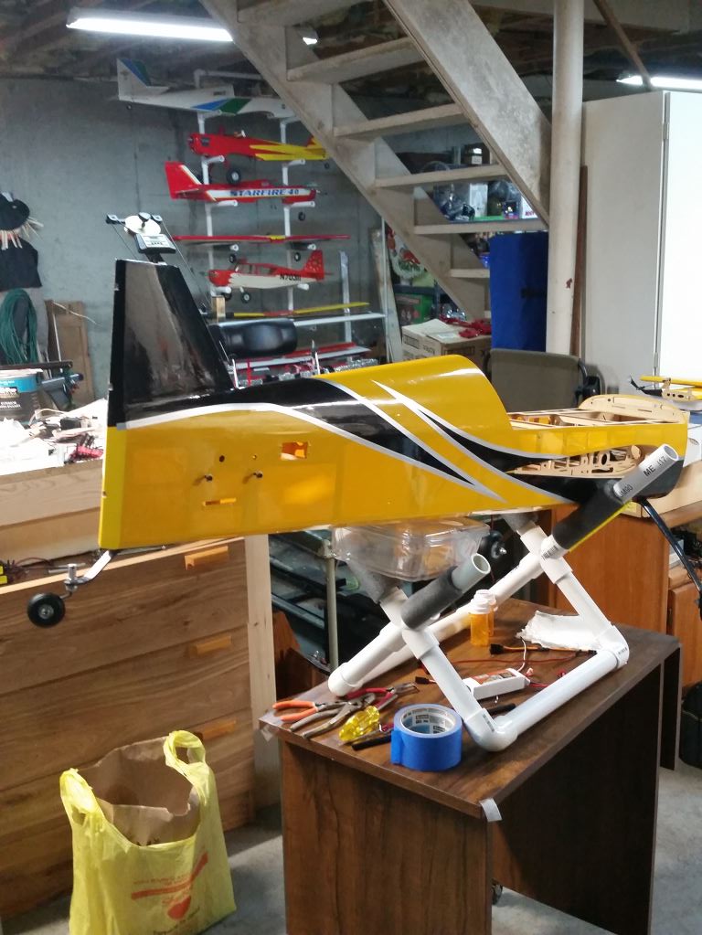

With tail feathers removed
Rudder back on, taped while epoxy hardens
